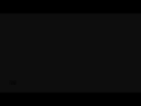

I bought Zenbook Pro Duo and the first thing that caught my eye was the uneven backlight of the screen. When displaying e.g. 5% gray, using a video on YouTube at this link and reducing the screen backlight, you can see a large unevenness in the brightness of the backlight. I will point out that the problems I describe can be seen best in a dark room, when working during the day the problems are not visible or are very poorly visible.

  • First of all, OLED screens, like the main 15" screen of the ASUS ZenBook Pro Duo, do not have backlights. They are emissive displays where each pixel produces its own light when activated.
    That being said, you should be seeing a solid image with a solid screen like that of the 5% gray video that you linked to. I tried it on my Pro Duo in the dark and did not notice any difference in the illumination of the screen even at low brightness settings. If your screen looks normal in normal viewing conditions, I wouldn't be too worried about something that only occurs in the dark at extreme settings that you're not likely to use anyway..

  • @gszkop
    In looking at the photo of your screen, if the photo is a good representation, it looks like the left side of the screen is slightly brighter than the right side, but not by much. It also looks like you have a stuck pixel in the lower right hand corner. Personally, I don't think the brightness difference is really anything to be concerned with as you have to set the brightness very low to see this. I would be more concerned with the stuck pixel that's on all of the time as when I see those, I can't unsee them and wind up looking for it all of the time. On a generally light or white background, you won't really notice it, but on a dark background, it jumps out at you.
    I read through the article that @braintheboss linked and I don't see any of those types of artifacts on my screen at all. It is very clear and sharp and consistent in brightness across the screen. I'm not sure how similar the panels are between the Dell screen and the ASUS screen as our screen is a touch screen where the Dell is not, so at least some of the specifications are different between the two.
    In the end, it's up to you as to whether or not what you see on your screen is acceptable, but with what you've shown me, I think you're well within the normal range of variation of the screens and I wouldn't be worried about it
    Good luck and let us know if you will keep the laptop or return it.

  • Yes. I check with this video
  • gszkop posted on 2019/11/2 21:02

  • @gsztop
    I looked at your pictures and am not seeing a bright line across the middle of the screen. In all of the new pictures all that I can see is that the left side of the screen is considerably brighter than the rest of the screen.
    I guess that I must've gotten a good one as I am not seeing anything like your photos.
    How low are you setting your brightness to see this? I can go almost all the way down and the image still looks good to me. But, if you're well below the normal brightness that you operate the screen at, why worry about what it looks like? You will never run it that low normally, so it shouldn't really matter what it looks like. Does the screen look even at normal brightness levels?
