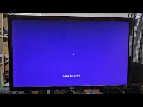

https://youtu.be/w6p2hsyyVZ0
This is what I see on my other mainboard with B550 chipset with current version of BIOS.  Exactly same problem occurs with the mainboard in question.  I suspect all your mainboard with B550 chipset with the current versions of BIOS are all having this same issue.
I have cleared the BIOS.  I have tried with entirely new set of SSDs.  I have tried a M.2 NVMe SSD adapter PCIe card.  None works

Why was it necessary to abort the installation and return to the BIOS to verify RAID settings before completing the Windows installation?
Based on the unclear video footage, could you please confirm whether, at the timestamp 03:28, you clicked on "Delete"? There seems to be no such step mentioned in the FAQ.

The reason that I went to back to BIOS without installing Windows was because my purpose was to show that RAID array member drives are visible while they were not supposed to.  If RAID was working, Windows will see a single drive (often after loading RAID driver) rather than two separate drives since I created a RAID 1 array.  Seeing two drives means RAID is not working.
