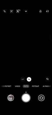

sudah update software terbaru, tetep ga bisa, harusanya ROG berbenah untuk kasus ini, karna sudah banyak kasus dari seri terdahulu, menyesal sudah

Yes, I have tried it and have updated the software manually, but it still doesn't work. It was suggested to reset it, but I haven't reset it yet.
