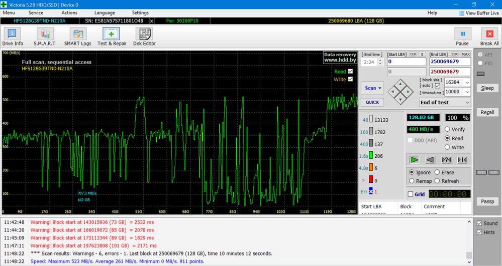

First disk “surface” scan using Victoria:
As you may see I had uncorrectable unreadable sector at ~75GB, see speed drop to 0MB/s, as well non zero Err counter. Linear reading speed dropped many times from 300+MB/s down to 100 and even 50MB/s. Speed dropped because so many sector blocks took 2 and even 5 seconds to read. I guess it could be something like floating gates self discharge. Data wasn’t refreshed often, so perhaps it was something like that.

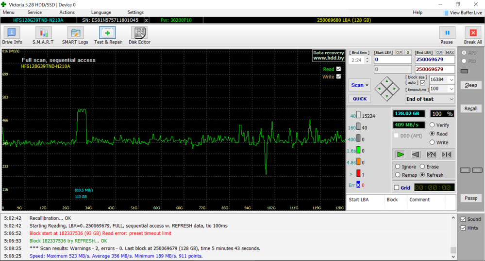

I had to erase lost sector to be able to make backup ASAP. I found later that Macrium Reflect has option to ignore unreadable sectors, but I was at hurry saving my data, so I erased just those unreadable sectors. Err counter became 0, Reflect had no problems doing backup. After backup was done I did several whole disk readouts with Victoria. This was increasing some RAM S.M.A.R.T. counters, but speed drops on slow sectors became less frightening. Finally I did read-write refresh on slow sectors, and it restored sequential read speed. See how it looks now:
Just perfect, slowest 16k block takes 0.03s to read. I guess those areas with ~500MB/s speed belong to erased locations and ~300+MB/s areas belong to used locations. These 500/300 jumps are quite odd for SSD, but I don’t mind them. I didn’t do whole disk read test soon after buying, would be good to know how it looked like on new Hynix SSD.

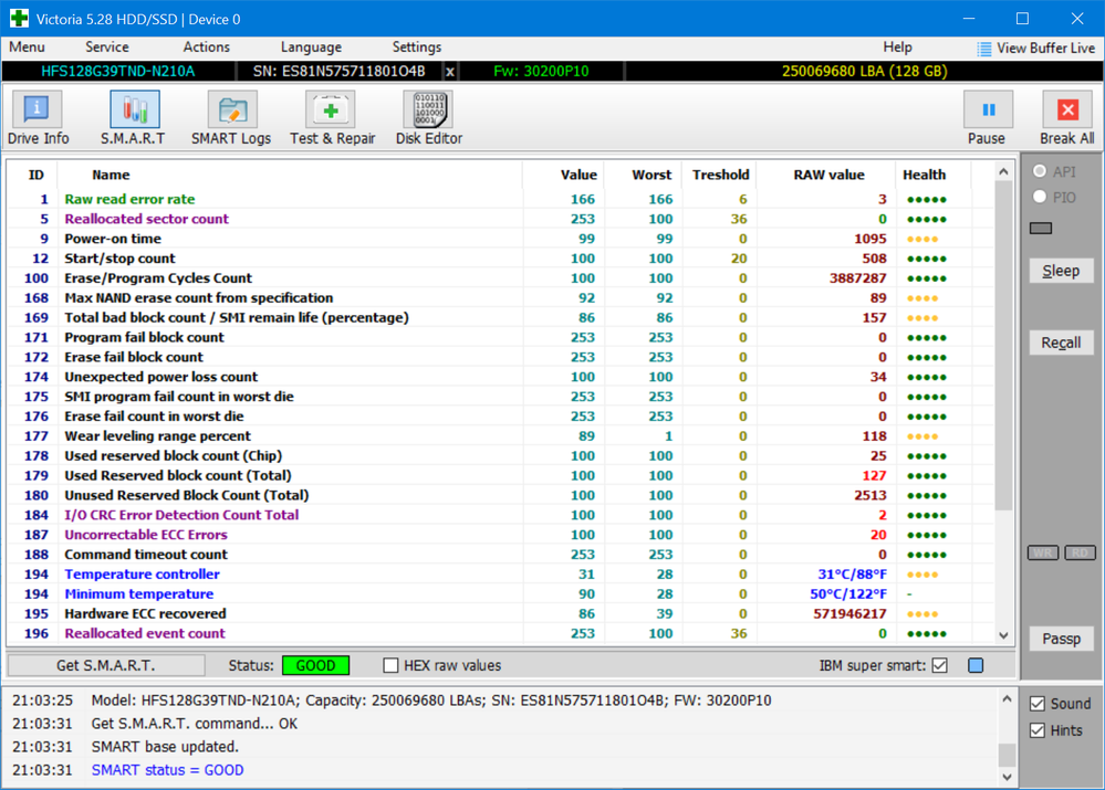

Here’s S.M.A.R.T.:

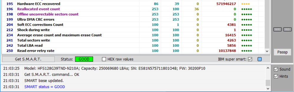

and the rest of S.M.A.R.T.:
GOOD. Oh yeah, unreadable data is “certainly GOOD”.

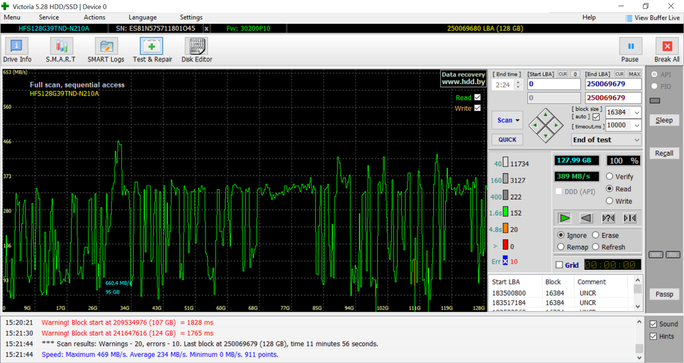

Another Zenbook suggested by me to my relatives had worse situation:

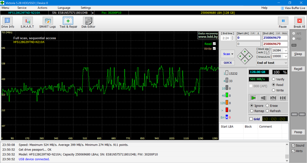

thanks for your attention. I retested both UX331UA's after a week. As I suspected, solution to refresh slow sectors is temporary. Areas of slow linear read speed slowly come back and reappear. Here's how my laptop with 4TB written looks like past the week. Please compare to the first (before refresh) and to the second (after refresh) picture from my first message.
