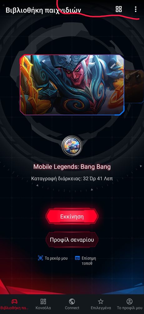

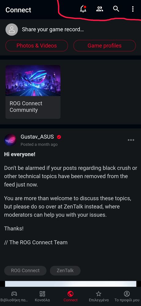

Today my phone didn't response on touching in the uper right place( above the selfie camera) until the middle of the top speaker. I attach photos and a video. Is it hardware? Factory reset will do anything? I have done factory reset a dew days before. Do i need to do one more factory reset, it woll solve the problem?? Anyone else facing this issue?? Restart the phones does nothing just to say
On the video i turn over the phone as u can see and from the oppooy side i can adjust the brightness (it responsers as it used to be) but on the normal it doesn't responses at all!!!. It does the same on everything in that area (from selfie cam to top speaker)
Omg i hope it is not hardware problem and have to ho to warranty service.
